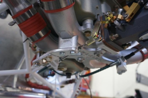

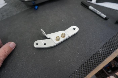

Brief Description:  Throttle cable bracket part 2
Completed fabrication of the support plate for the throttle bracket. Drilled holes for bolting on the VA-163 bracket. Trimmed support to final shape, filled and deburred edges. Bolted support in place. I still need to prime and paint it and replace the hardware store bolts with aircraft quality bolts.
Installed engine control cable firewall pass through fittings.
Installed Adel clamps to secure engine control cables to the engine mount.
Completed throttle bracket support

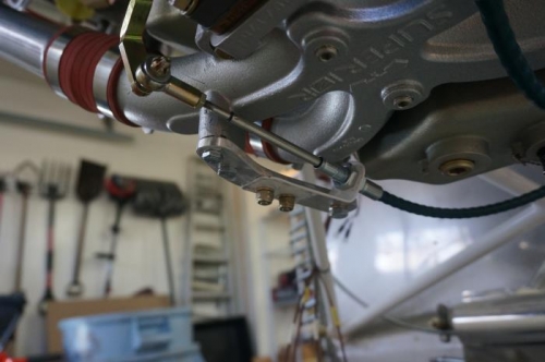

Throttle cable in place
