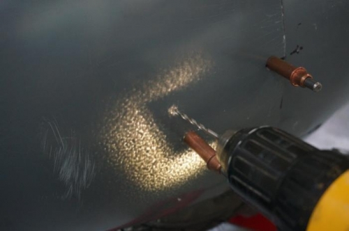

Drilled the holes that mount the RH fairing aft half through the U-808 bracket and the U-807-R bracket using the same methods I used for the LH side.

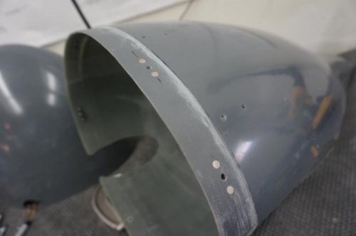

Drilled out the holes that mount the wheel fairing forward halves ot the aft half and installed unplates on the flanges of the aft half.

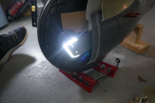

Applied some epoxy/flox to the inside of the aft fairings where the upper flanges of the U-808 contact the fairing. Reattached the fairings without clecos in the upper two holes of the U-808. The epoxy/flox will act as a liquid shim that will fill the uneven space between the U-808 and the fairing.
Drilling in inboard aft half attach holes
Nut plates installed
