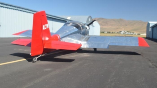

Number of Hours:  9.50
Brief Description:  first engine start
The canopy has been installed again. w eight and balance is done. 1041 lbs. I ran several W&B senarios and much like Vans specs, only one potential issue. If I have myself and a180 lb. pax and 100 baggage with full fuel I will be under gross and in CG. However, as the fuel burns off the CG will move out of the aft limit. first engine start today went well. No leaks found and I was able to set idle.
