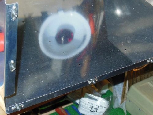

Rear baggage floor arrived. I found it easier to use a dremmel to radius all the corners this time as the piece is awkward to manuver on the grinder. Drilled , debured, dimpled, and riveted on the eight platenuts.
