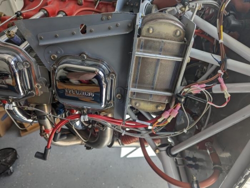

Then I started to work on the engine and did the EGT & CHT connections, running the wires as best as I could ... I find it difficult to do it as perfectly clean as I have seen on some other sites. The result is not too bad and best of all it is done.

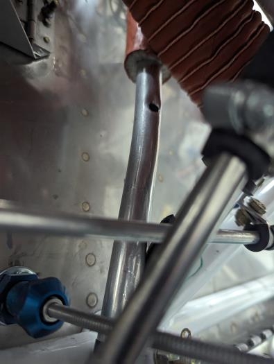

I then connected the expulsion tubing going above the exhaust from the oil separator. I used 3-4" of rubber reinforced tube (oil resistant) , which was fixed on an aluminium tubing for the rest of the run. About 6" from the bottom, I drilled a 1/4" hole and pressed the top of the toward the inside, making a depression like a whistle. The goal is to have no fumes inside the engine bay but a hole in case the bottom plugs up. The whistle shape is a bit like a venturi and should prevent fumes exiting but if the bottom cooks or gets blocked that second opening will prevent pressurizing the crankcase. I did not invent that but a pilot friend explained to me the importance of doing that . One very important thing is to cover the tube to keep those fumes as hot as possible because it's when they cool down that the problem might be creating itself. So I put a silicone/fiberglass tubing over the length above the whistle.

EGT, CHT, spark plug wire run .
"Whistle" in view
