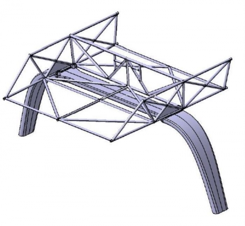

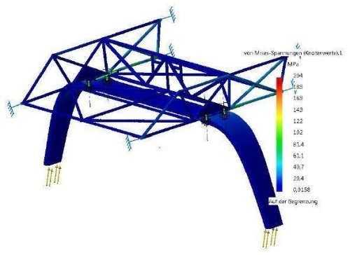

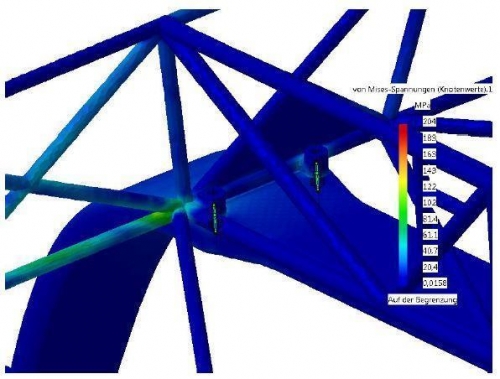

Brief Description:  FE-Analysis of the main-gear-subframe
The new main gear configuration with a glass-carbon-hybrid laminate needs to be checked via FE-Analysis. The model is based on a reverse engineered subframe of the kitfox and static loads form the FAR regulations.
