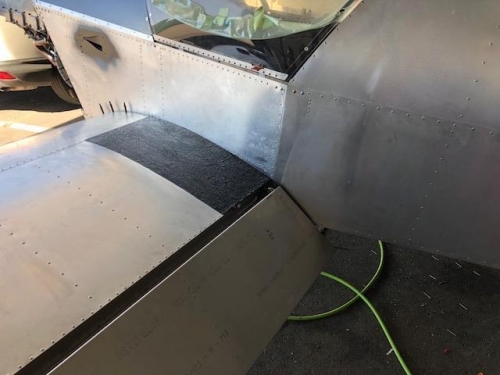

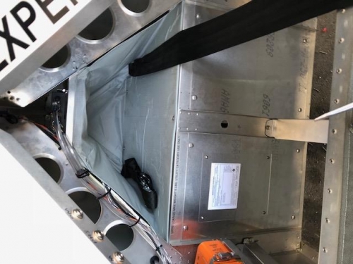

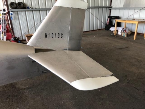

I installed the hat shelf section and closed in the cargo area with aluminum. The base of the hat shelf secures with Soutchco fasteners. The fabric attaches with Velcro. I also secured the cargo boxed in sections with Southco fasteners. I decided to install a piece of Lexan on the back cargo wall to display the airworthiness and registration. To finish out the day I painted the wing walk doubler with Ultra Wing walk compound. I used this in the past and found it durable and gentler on knees and elbows. Instead of feeling like sand paper, it is more like chunky rubber. I also installed the tailnumber in 3" vinyl.
