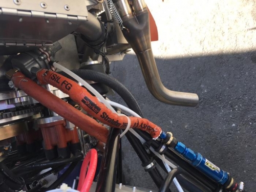

Wire bundle with 3 Adel clamps and fitted heat shield

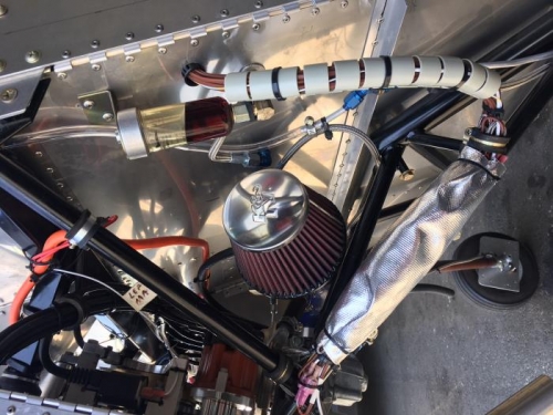

Clamped fuel lines.
Clamped fuel lines.

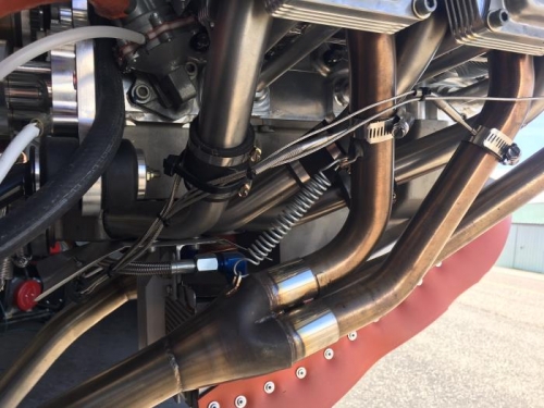

EGT Probes secured
EGT Probes secured
