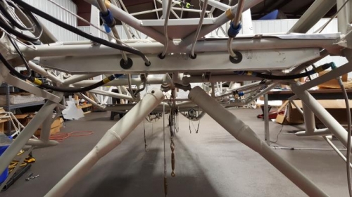

Brief Description:  bulkhead pass through
Perusing the internet, I came across a picture of the small bulkhead located below the pilots knees that the fuel lines, brake lines and electrical wiring must pass through. I neglected to do that the first time I ran these lines, so... out comes the pipe cutter, flare tool and bender and I re did the lines that would not otherwise fit. So all but the right brake line had to be re-done.
