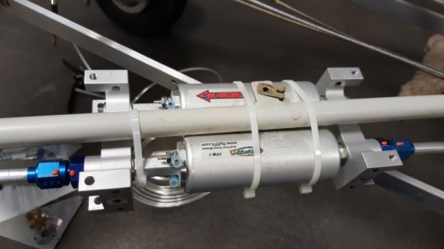

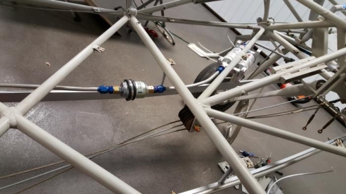

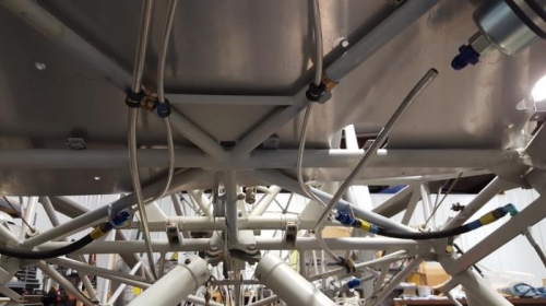

Brief Description:  Hard lines
Ran the fuel lines from the header tank area to the firewall, except for a break where the fuel shutoff will be. I have an Andair unit that is not going to work the way I'm plumbing things. Ran the return line also, without breaks. I'm planning on having a fuel shutoff valve at each wing root so that I can balance fuel. Also ran all the brake hard lines.
fuel filter before the pumps
fuel pumps
fuel pumps
fuel filter after the pumps
