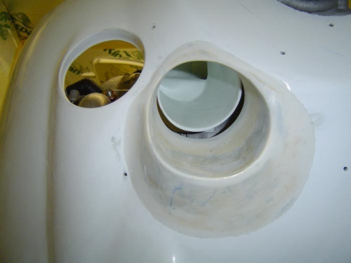

Brief Description:  Inlet for the fins on the engine cylinder head

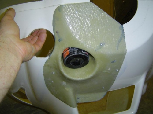

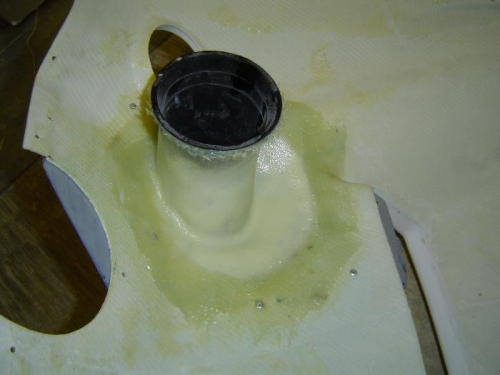

Now the engine is finally hung. I could now fit the engine cowls. First I had to create the air inlet for the fins on the engine cylinder heads. I’m supplied with some splash mouldings from Europa. The hole is cut in the cowl and the moulding is fitted. Bid is laded up on the inside and when the splash mould is removed leaves a nice smother moulding to the cowl.
splash mouldings
splash mouldings
Inside With Bid Layup
Nice Finish
Nice Finish
