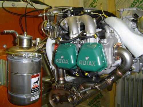

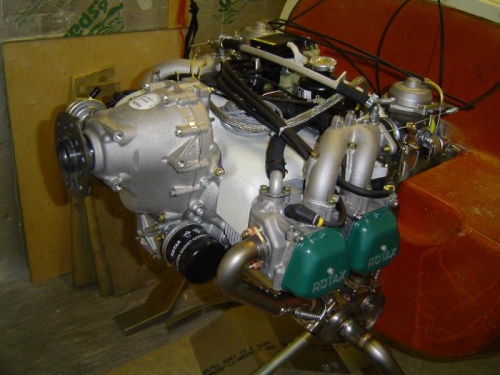

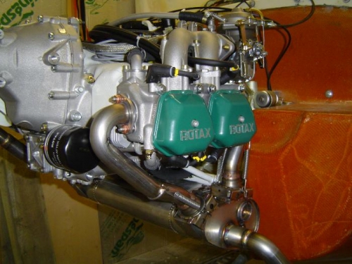

Brief Description:  The Engine arrived
The Engine arrived in December after only a 5 Week order. I couldn’t wait to hang it. So on the 14th December, It was installed. Hanging the Engine is not too bad. The difficult and time consuming part is getting the Engine to be off set to the STBD to compensate for the Thrust. Washer are added behind the engine frame and the angle is set by measuring the distance from the fire wall to the pop flange via a straight edge.
Once happy with the angle. I fitted the Exhaust and Oil Tank.
