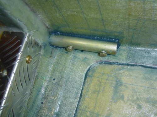

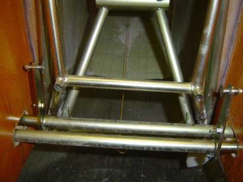

The Fixing of the landing Gear frame is simply a matter of making a small hole at the bottom of the tunnel to let the frame through into the cockpit; the top tubes are slid inside the tunnel. The frame is then drilled and bolted in place through the hard points in the CM.
Bolted in Place
Bolted in Place
