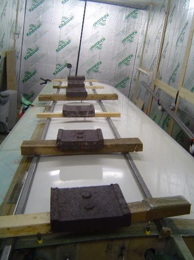

The Final fix of the top skin

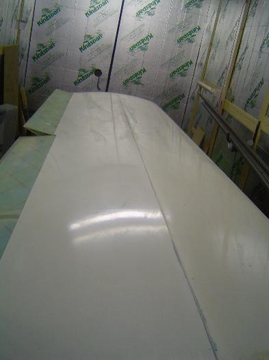

The Final fix of the top skin. Redux is put on all the contacting surfaces. The Top is put on a weight down to get everything straight with no lumps or bumps in the surface. This has turned out well
Redux
Finishe and closed
