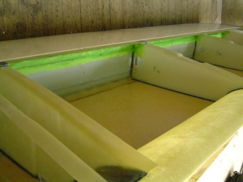

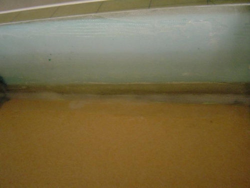

Wing has to be re-enforced
The wing have to be re-enforced from the spar to the skin, first adding a flox corner to avoid air bubbles. All laid up top and bottom of the spar and skin. All prepared by first scuff sanded.
Re-enforced
Flox and re-enforced
