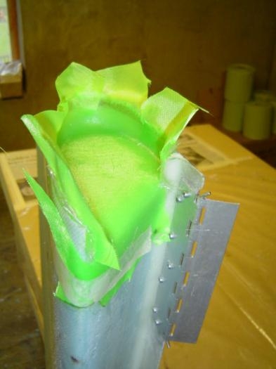

Brief Description:  Rudder Horn
Today has gone well, prepared the rudder for fixing the rudder horn plate. Cut off the end of the rudder 13mm from the rudder bottom hinge at 90o. then scooped out the foam to 15mm deep. I decided to flox the back corner of the dig out as It would be hard to get the "bid" around the very tight corner. I put on 4 ply's of "bid" and over lapped onto the leading edge after cutting out the flange and rounding the corner. All pealed ply-ed and left to set.
