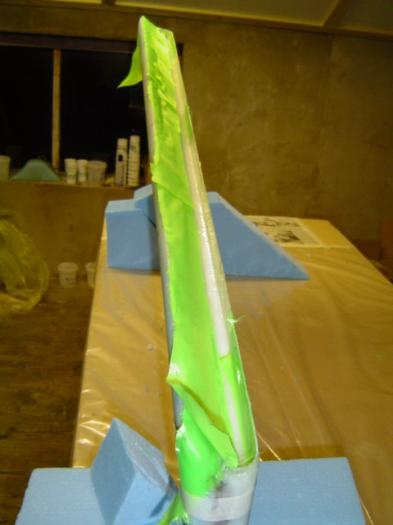

Construction Of the Europa XS
Date:  1-15-2006
Number of Hours:  3.50
Brief Description:  Close Out
Did close out on Rudder, all preparation went well. Put on the first ply pf Bid then the reinforcing ply's for the hinges, then the other ply of bid. Had a fet problems with the second ply of Bid, as I had mixed up too much resin and quickly got exothermic reaction, finished it off with a fresh mix. Spent time making sure there was no air bubbles underneath. All left to set.
