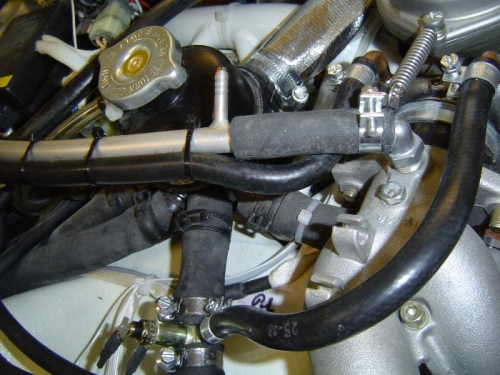

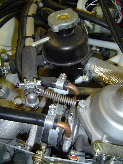

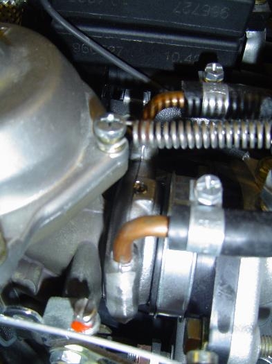

Brief Description:  Carburettors Heater
The fitting of the carb heaters is a choice I made. The heaters are fitted to the Carburettors and are supplied with hot coolant to pass through them, this in turn warms the body of the carburettor air intake to stop Ice forming dew to convection as moist air is drawn into the engine. Very simple Idea that could stop and cause an inflight engine failure.
