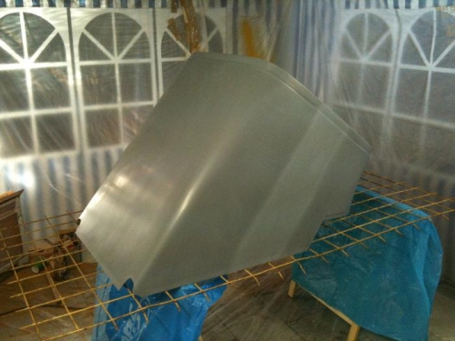

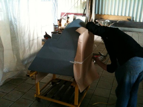

Used 600 grit waterproof sandpaper to sand the bootcowl and cowlings.

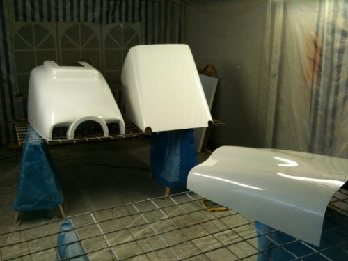

Sprayed one layer of white epoxy-primer on to the cowlings.
Let this dry for a few days before sanding out the imperfections caused due to spraying, I had a few runs, took care of them with 400 grit sandpaper.
Spraying the final color will be the next thing to do.
