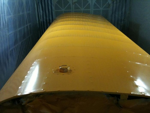

Brief Description:  RH Wing final Color
Since the first layer of yellow polytone did not cover to my satisfaction I had to spray a second layer.
Cleaned entire wing with C-2210 paint cleaner followed by a tack rag to collect last minute dust.
Mixed the yellow Polytone 143 with reducer 4:1
I had to wait for more then a week before spraying the second layer yellow, it rained most of the time so humidity was way to high. We are witnessing the wettest summer since 1916, not good if you want to paint some parts, humidity is over 90% most of the time.
Now the rh wing is finished I continue with the rudder and other small parts, many parts need to be painted before the winter arrives.
