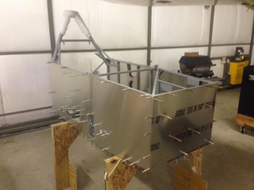

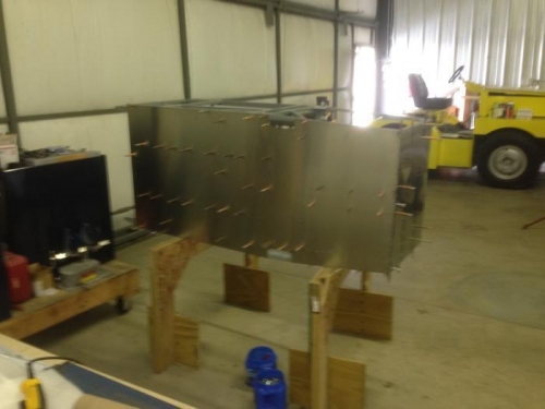

I spent Friday and today drilling the side skins, firewall
and bottom skin. Everything is final drilled to #30 and
both side skins and fuselage cage holes have been
deburred. I have to remove the bottom skin tomorrow
and deburr that. I will also rivet all of the stiffeners
in the three skins that the BM suggests. When this is
completed, I will set the skins aside until the two
fuselages are joined together and everything inside
the forward fuse is in place as called out in the BM.
So far, I have spent 30.5 hours getting to this point.
This includes unpacking all of the parts included in the
shipment.
Firewall ready for deburring
Bottom Skin drilled to # 30
