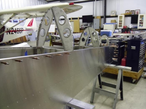

Prior to putting the turtle deck skin on for the last time
it is important to use a straight edge across all three formers
to ensure the rivet flanges all line up. If any of them are pushed down
there will be a big indentation in the skin where the rivet is set
as the rivet will grab the flange and pull the skin down to it.
Not what I want to happen.
Checking former flanges
