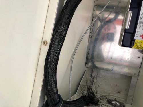

Brief Description:  Bundling Cables
I wasn't happy with the rat's nest of wires passing through the forward avionics bay (Also known as the lower forward baggage area).
I disconnected the already connected wires on the firewall side and pulled them back to add the "Chinese Finger Puzzle" wire bundle. This expands to about 5x its original diameter to allow the wires to easily fit through it. When finished, I will pull on the ends colapsing it and then wire-tie the sheathing to keep it nice and tight. For now I am leaving it open in case I need to pull any other wires thorugh.
Worth the time to remove/replace the wires.
Wire Bundle - Still open
