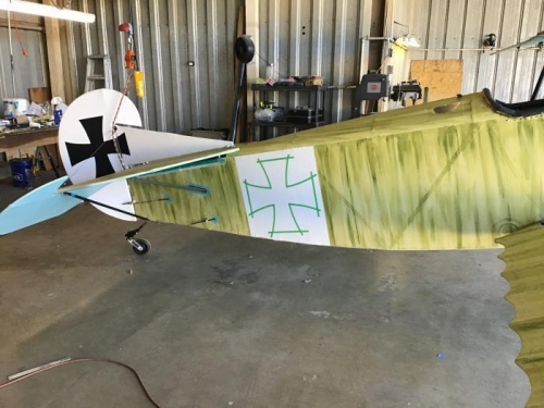

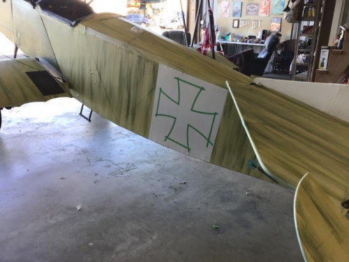

1. Add the cross insignia on the fuselage.
Status: A new cross template was created for the sides. The initial outline has been traced on and masked with tape.

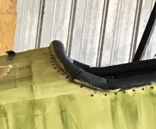

2. Punch the thru-holes in the fabric for the leather coaming's lacing.
Status: 95% complete. I used a soldering iron to melt the fabric and open the holes that had been previously drilled. I found a few spots that will need holes drilled sometime in the future.
Right Cross Pattee Mask
Left Cross Pattee Mask
Lacing Holes
Lacing Holes
