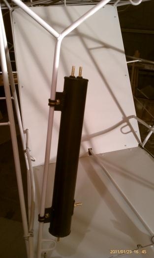

Installed the header tank . The header tank has four tapped holes with hose barb fittings, two in the top, one on the side and one on the bottom. The two top fittings accept fuel from each wing tank, the bottom fitting goes to a fuel drain and the side fitting goes to the engine. Any water or debris that gets into the fuel will seperate and go to the bottom where it can be drained off, this allows the engine to get nothing but good fuel.

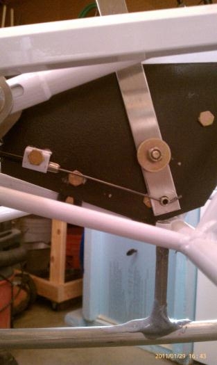

The manual trim was installed next to the flap handle.
Trim - mounting bracket

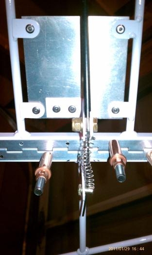

Trim - connection to the wing tab
Header tank painted and installed
