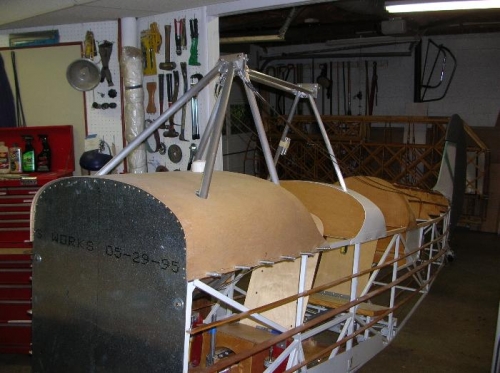

Brief Description:  Fuselage additions

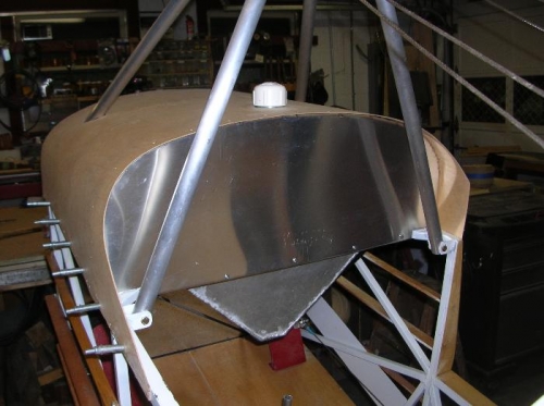

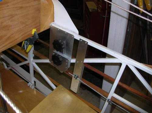

The front center fuel tank is now installed in it's correct and final position. The top front forward skin is now fitted and ready for final finish. I have created and assembled a control for the Elevator Trim Cable connect and installed it on the right side of the Fuse in the rear Cockpit. I've also made and installed a .025 6061-T6 Aluminum panel skin for the front cockpit replacing the very flimsy plywood one supplied ( I believe at little additional wgt gain) it is stronger and stiffer and makes a better mounting surface for the forward top skin to attach to. This skin is put on with nut clips so I can remove it at will to access under it. The Fuse, as it sits in the photo's below is almost ready to comer with Fabric. The firewall is also now installed. I've formed and attached "L" angles of alum and added nut clips for easy installation and removal of the top forward skin also. I need only to install the guide blocks for the Elevator push rods in the Fuse to complete it for fabric installation.
