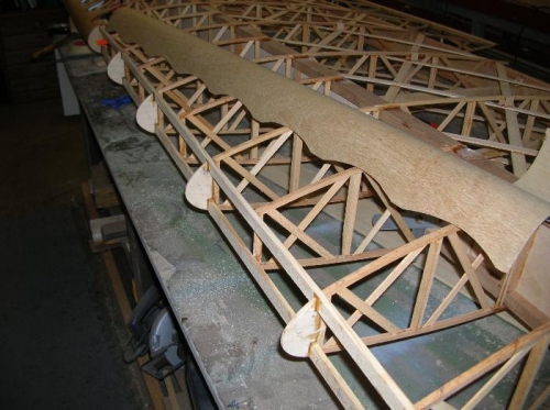

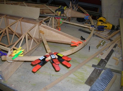

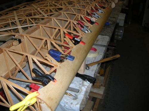

Continued to work on Wing - top left. Fitted attached the bow to the tip end - adding the called out bracing and gussets.. The ply for the leading edge was soaked and installed in the bending jig and ready for installation. Today I marked and cut the scallop edge in the trailing edge of this ply after fitting it to the Wing. I then mixed up the T-88 and painted the surfaces it will attach to and back painted the ply itself then applied it to the first section of the leading edge. This takes a bunch of clamps so I can only do one section at a time (approx 3') when this piece dries over-night I'll fit and glue the next and the next.
Bow, braces  and Gussets fitted and glued to the top left Wing
Leading edge ply bent and scalloped ready for installation
Lead edge ply glued and attached to the top left Wing leading edge - 1st section of 3
