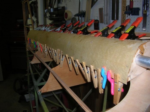

Part two of this date show the Ply leading edge glued to the top of the Aileron.

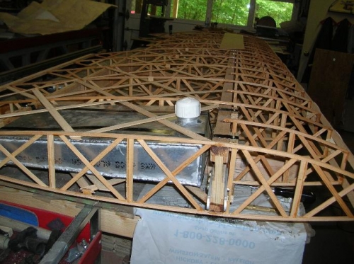

I have also started to fit the Top Extra Fuel tank (one for each wing) to it's location. They are install using banding straps top and bottom to suspend them in the first rib bay of each top wing. Geo strips are then installed over top of them. They were left off the Geo installation of each wing in this location until the Tanks were install. There is little of no explanation or installation instructions on this anywhere on the plans except for a single drawing showing the banding installation location and the additional mounting blocks used to anchor them. They fit the space very well and look like they'll ride there quite well. They will be side by side and directly over the main Fuse Tank forward of the Passenger compartment panel - behind the firewall. They will function as extra reserve fuel to be transferred to the main tank when needed. Don't how much use they will get and the connection methods are up in the air at this point as well. Each step in it's own time.
Leading edge Ply glued on Aileron of Left top Wing - waiting to cure
Early fitting of Fuel tank in this Wing and Geo's that go over it.  They are not glued in/Tank full in
