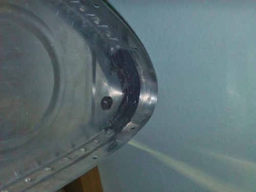

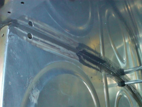

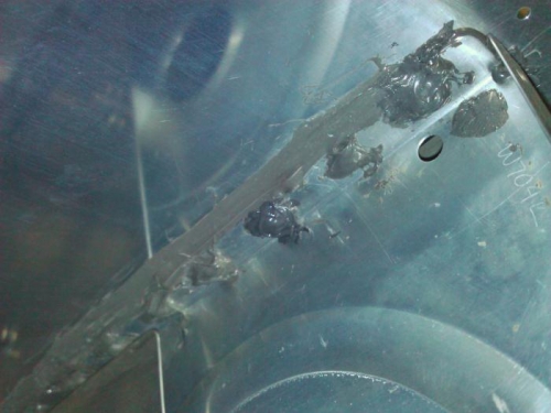

I decided to carefully inspect every fuel tank and add additional pro-seal anywhere where I thought there was a remote opportunity of a leak in future. Any areas that I had even the slightest doubt about, I cleaned and applied additional proseal
Additionsal proseal to outboard leading edge of one of the tanks
One place where the was a tiny void in the fillet
Some shop heads that didn't look quite to spec get more pro-seal
