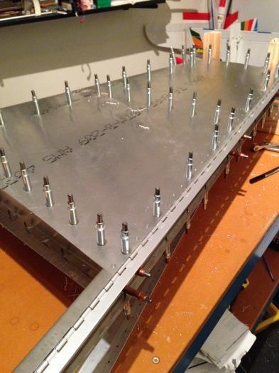

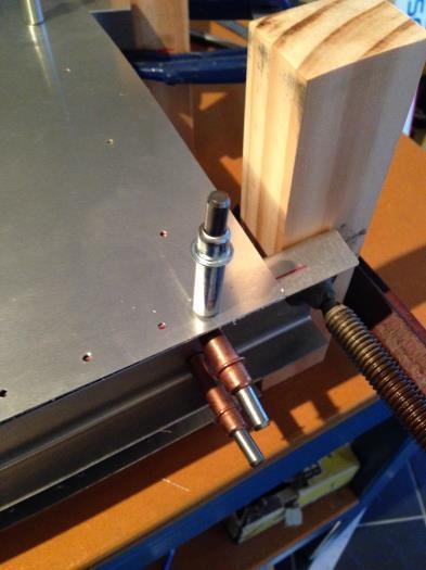

Blocks of timber were made and clamped at centre height on the spars. Important to make sure enough clearance for the skin to fit correctly - at least 1" away from the edge.
It was a simple task tonight of marking centre lines on ribs and drilling the first #40 pilot holes on the top of the spar both sides.

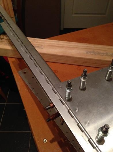

Then it was a simple task of cleko first hole, align skin and drill skin to ribs using the #40 holes as pilots.The hinge was marked into position (second hole down) and first hole centre punched and drilled then use the skin holes as pilots to match drill the hinge. I then moved the hinge up a number of holes to complete all the holes in the bottom of the hinge then returned to correct position and drilled bottom holes through spar using the hinge as a pilot.

First hole drilled in spar and skin aligned
Drilling hinge
Drilling hinge
