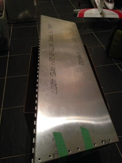

Stripped elevator of all clekos and deburred all holes.
Dimpled the required holes on the surface for the countersink style pulled rivets (aluminium). I found it was easier when working alone to use the close quarters dimple set to dimple the centre holes in the elevator and end holes on the ribs rather than the C frame.
Finished assembly of elevator looks great.
