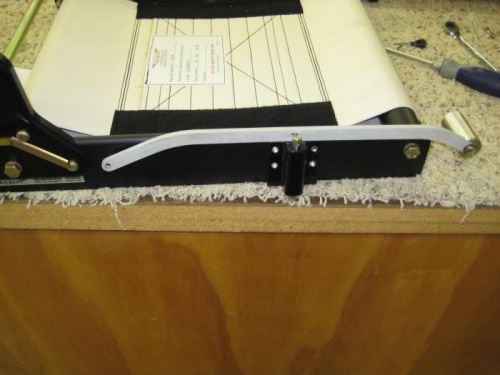

Removed the seat adjustment assembly from the seat base. Holes in the assembly were drilled and tapped for AN4 bolts. Holes in seat base were enlarged for AN4 bolts. This mod was previously detailed.
The Aerosport seat adjustment levers were then installed.

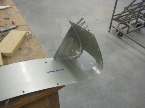

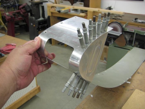

Next, I used the extra tank ribs that I ordered to fabricate a riblet. This riblet will be riveted in place on the lower wing root fairing and will maintain the shape of the wing at the unsupported side. I felt this was required as the taxi light hole removed a portion of the leading edge curve in the fairing causing a change in shape when the fairing was installed. This distortion is eliminated with the use of the riblet.
The original rib was modified to fit and the fairing was match drilled to the riblet. Clecos were used as the holes were drilled.
The lower faing was then taken to the hangar to verify fit. Some minor modifications are necessary and will be completed tomorrow. Overall, it fit well.
