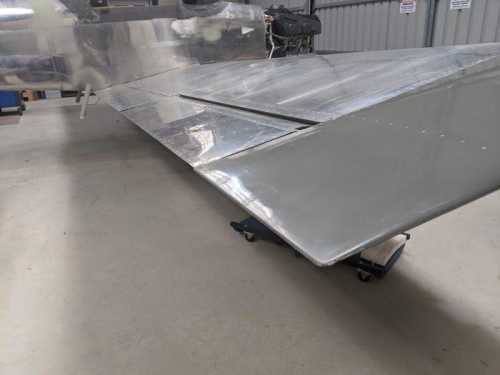

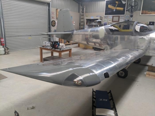

The right wing tip is now finished.

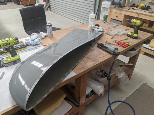

I decided to fit screws to each wing tip, so they can be easily removed during inspections. I spent hours drilling, countersinking and installing the 36 nutplates, but the end result is well worth the effort. The tip fits very neatly, and the trailing edge lines up nicely with the aileron and flap.
Happy :-)
A few hours spent drilling and countersinking
The right tip fits very neatly
Trailing edges all line up nicely
