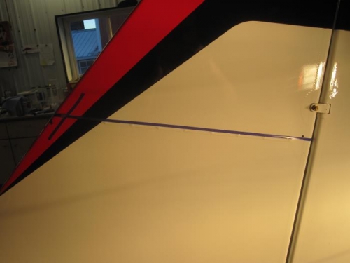

The rudder was really straight forward, except that I did not mark the upper hinge bolt hole when I painted the fuselage. I called the factory and they gave me the measurements, which I made and triple checked before nervously drilling into my freshly painted rudder post - Success!!

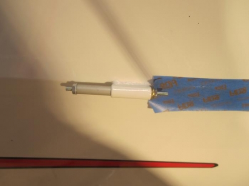

The stabilizers gave me some troubles. I "pressed" the bushings in using a long bolt, which worked well, but when I tried to pass the bolts through the stabilizer and fuselage bushings together I just could not get it to go. Taking it back apart and gently reaming the bushings finally got them to go, but it was not without a few choice words.

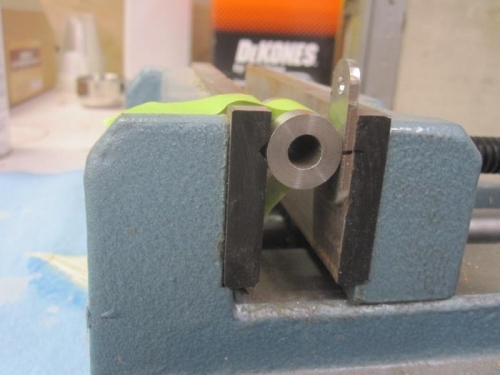

I used a piece of round steel tubing and my vise to bend the tail strut tabs, which worked well.
Bending the tail strut tabs.
Tape to find where upper hole is.
"Pressing" bushing in place.
