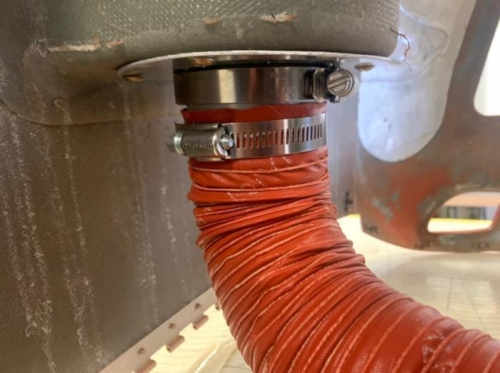

Step 1: The FF-00120 was removed from the COWL-00006.
Step 2: The air inductuctio filter assembly was created using the indicated parts. the air induction filter assembly was attached to the COWL-00006.

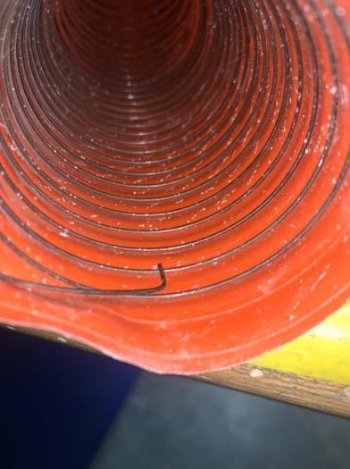

Step 3. A 13'' piece of 2.5'' diameter SCAT tube was cut to create the FF-0121.
Step 4. The wire from inside the FF-00121 was unspooled up to 3/4'' fro one end of the tube. The first halof of the unspooled wire was cut off. The first 1/4'' section of the remaining wire was bended at a 90 degrees angle.
The unspooled wire was twisted to reduc its diameter within the FF-0021. The end of the wire was turned inside of one of the wire loops still attached to the orange material.
5. The FF-0121 was attached to the engine and to the air induction filter assembly.
6. The rotax ambient air, pressure, temperature sensor to the air induction filter assembly.
7. The AAPTS was adjusted and final torqued to the FF-00022
