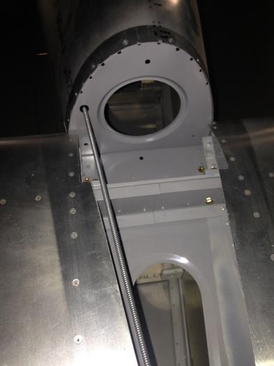

Holes were opened up to 3/8" in formers and drilled as required in instructions to run trim cable through tail cone, plastic guide bushes installed and cable run through.
Clamps were installed on vertical stabiliser and rudder cable guard as per instructions.
Horizontal stabliliser supports were permanently mounted to tailcone and then stabiliser mounted.

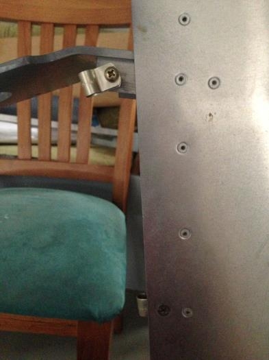

Trim Cable
Trim Cable
Clamp on vertical stabiliser
