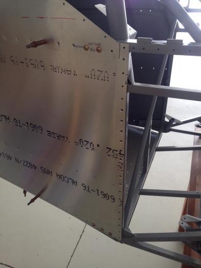

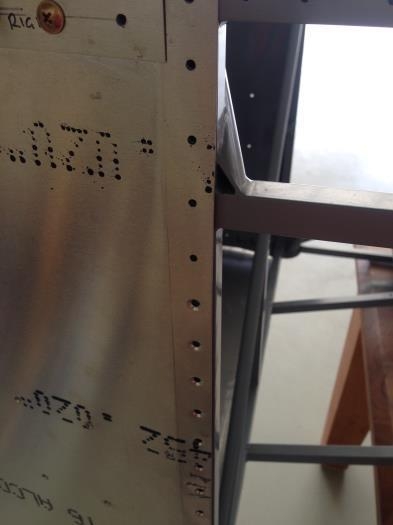

Dimpled holes along the join line, decided to use a combination of flush and protruting rivets as necessary due to not being able to dimple every hole easily in fuselage frame.
Dimpled sides of tailcone to match.
Fitted hardware bolts along sides and top to join tailcone to fuselage frame.
Re-fitted landing gear.
Painted some of the internal panels.
Hardware fitted
Hardware fitted

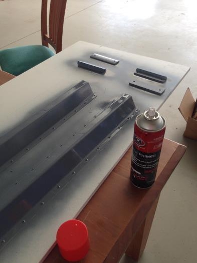

Dimple side skin
Dimple side skin
Etch and paint mid grey
