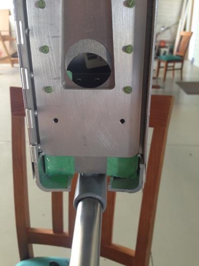

Trial fit of vertical fin showed a problem - it does not fit....
I checked online manual for answer but it was not explained. Various searches of other builders web sites solved the problem - thanks guys....

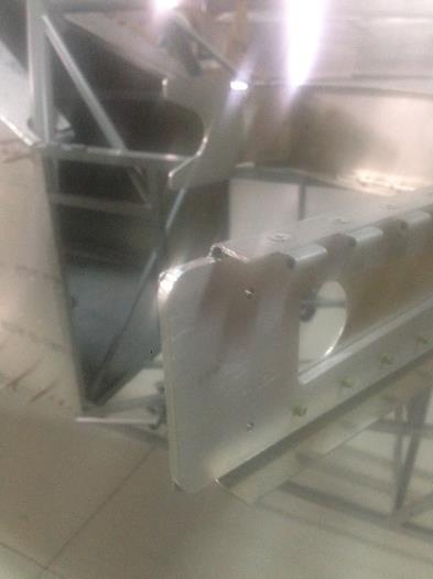

The rear spar flange needs to be trimmed back (including removing the last hinge knuckle).
A picture tells a thousand words.

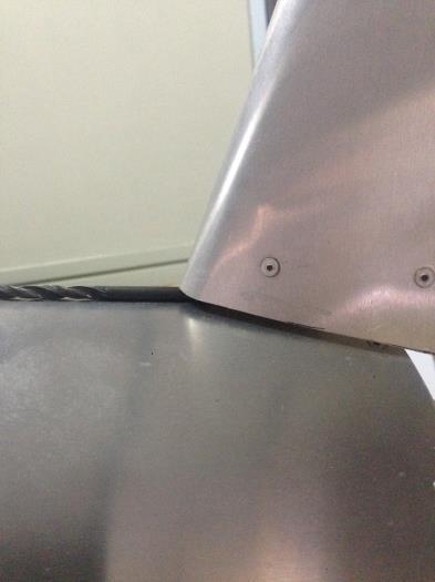

The vertical fin needs trimming to clear top of turtle deck, this was slowly done until a 3/16 drill could be used as a spacer.
spar does not drop down - trimming required
cut out rear flange 9/16
cut out rear flange 9/16" for good fit
Trim skin until a good clearance is achieved
