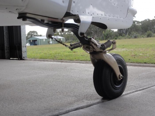

I had always been concerned about the tail wheel mounting setup and this has proved to be founded with the mild steel mount plate bending up, so I replaced this plate with a thicker 12mm spring steel plate which has solved that problem for the time being.

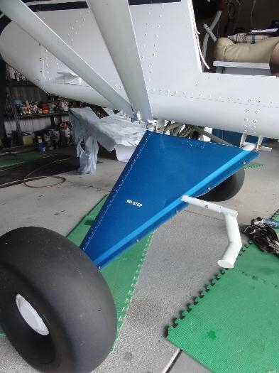

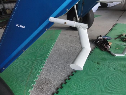

I had received numerous comments from passengers that the step was hard to use getting in & out of the cabin, so I made up a couple of decent foot landings and bolted them into the aft facing tube step, Bingo, problem solved.
Cabin entry Step
Cabin entry Step
Beefed up tail wheel mount plate
