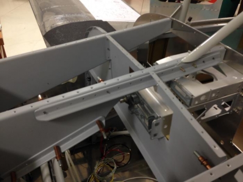

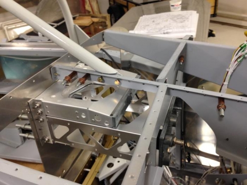

Brief Description:  Forward rib modification
Tonight I headed out to the hangar with a plan to clean up my center rib modification and move on to the next phase. In order to do this, I needed to complete a couple of tasks, the first of which was to remake the spacer that went the length of the reinforcement bracket. Yesterday I made the spacer from some scrap .050" aluminum, but I really needed something more like .0625". After digging through the scrap box, I found a piece that would work, but wouldn't you know...it wasn't close to the right shape/size. By now, anyone following this knows the drill...mark, cut, file, deburr, trim, etc.

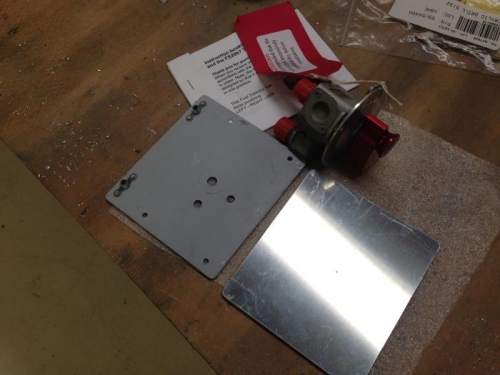

With that done, I cleaned everything up and primed the pieces. Nothing too interesting there. With the primer drying, I next turned to the Andair fuel selector valve (a work of art, I might add) and started working on a plan to install that. Of course the stock Van's fuel selector plate won't work, so I started figuring out a plan to make a new one. But where to get another large piece of .0625?? It turns out that there is a piece included in the finish kit (for what, I don't know), but I also had an almost unlimited supply in the Van's instrument panel that is now going to go unused...so, cut away.

Final mod complete and ready for installation
Rib mod view from the left side
Remaking the fuel selector cover
