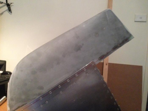

New hinge arrived, match drilled, dimpled and rivet back into the vertical stabliliser.
Tip countersunk and riveted to veritical stabiliser, rivet dipped in epoxy where located in fibreglass

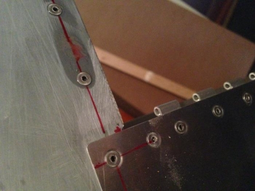

Countersunk holes in base of rudder horn and rivet ussing flush CCC-44 rivets
Hinge corrected orientation
Tip attached
Rudder horn countersunk
