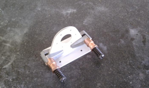

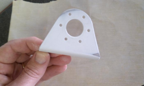

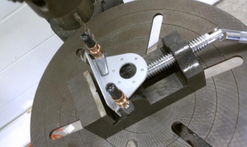

The elevator breaing bracket must sit flat on T.E. Spar surface. One side is drilled, the other must be match drilled. Left as much powder coat as I could while surfacing the brackets to get them to sit flat. I clamped them together on a mechinest granet to ensure the two flages where flush,then match drilled.
I will prime them to match the rest of the parts later.
Too Much Powder Coat
Clamp on flat surface
Match drill
Match drill
