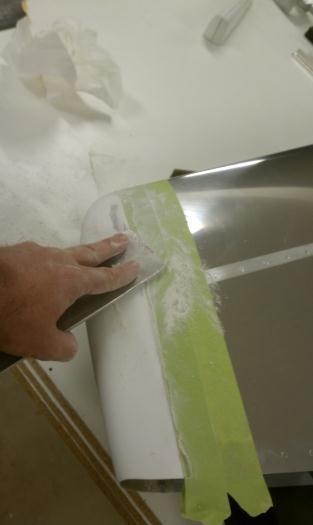

Manual Reference:  Drawing 6a

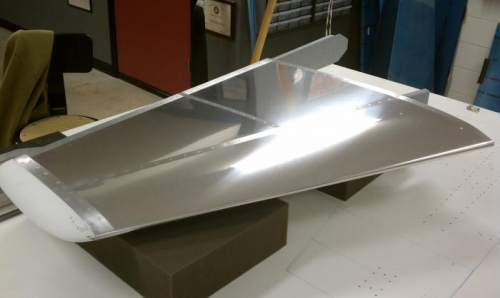

Brief Description:  Final finish on the fiberglass tip. Vertical stab
I used a sanding block to sand down the high points and identify the low points. I used a little bono to fill the lows and the seam. Also filled the pop-rivet heads. I put on a nice heavy coat of primer and called it good for now. We will do a final prep when it comes time to paint. But it is 85% there!
Vertical stab is complete, rudder is next!
87.2 hours, 2 months.
Use a sanding block!
