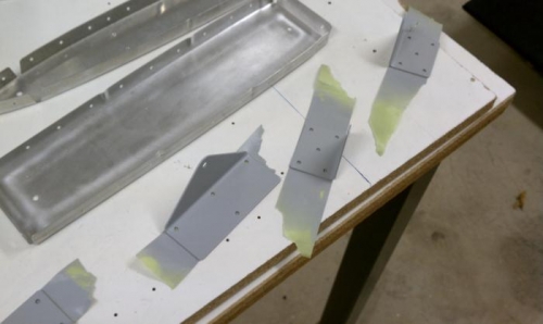

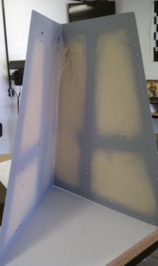

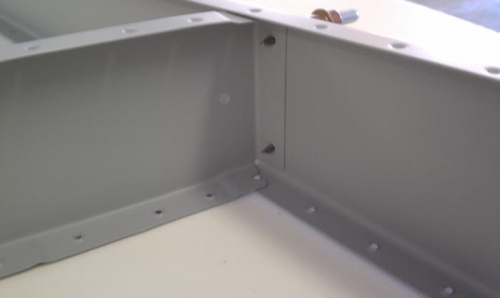

Another point of discussion is priming. There is a wide range of opinions out there. Ex-Navy Air-framers will tell you to use Alodyne, then prime with chromate primer, or the airplane will fall out of the sky after a year of operation! Some very experienced airplane builders will tell you it is all a waste of time as 2024 alclad does not rust/corrode and the primer just adds a bunch of unnecessary weight. What is the truth? The debate rages on......
After a little research, I decided to split the middle! I would prime all areas where there is metal on metal contact. I used a gray metal etch primer made by SEM. It is widely considered a chromate suitable sub and looks better than the Mil-Spec chromate green. I will only use Alodyne in the most critical areas, such as the wing main spar. Using this method, I hope to only add 10 pounds to the airframe in primer, while providing adequate protection for 20 to 30 years of operation. I have heard horror stories of builders adding up to 50 lbs. of weight in primer. I most certainly want to avoid adding that amount of weight.
Process:
1. Abrade with Scotch-Brite pad.
2. De-grease with Prepsol (PPG Product)
3. Heavy primer on flanges (two coats)
4. Light pass on the rest (one coat)
Primed only where the skin contacts the flanges

Primed Hinge Brackets to match
Primed Structure
Primed Structure
