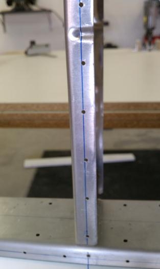

Match Drilling Complete!
Both sides are now drilled (one day per side). Time to remove the Klecos and see how we did!
One or two off target here and there, but over all, about a 98% hit ratio, acceptable to say the least. No complete misses.
Also did the final skin trim.
Ready to come off of the fixture!
Not Bad!
Tape line for trimming.
