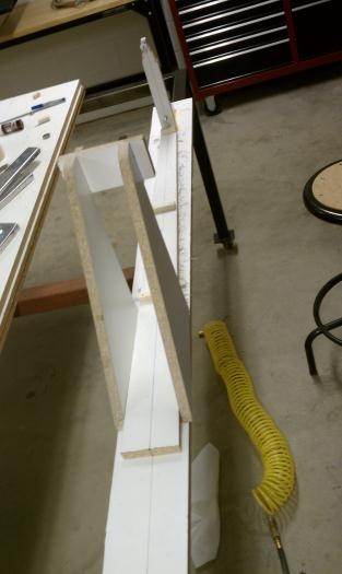

Manual Reference:  Drawing 6a.
Brief Description:  Vertical Stab Fixture
Holding it all true.......Started down the path of useing the Van's recomended fixture, but found that mounting the T.E. Spar by the hinges alowed the structure to twist. I decided that a stifer fixure was required so I designed this arrangment. Woked very well!
Gota love Melamine
Gota love Melamine
$21.00 for the materials
