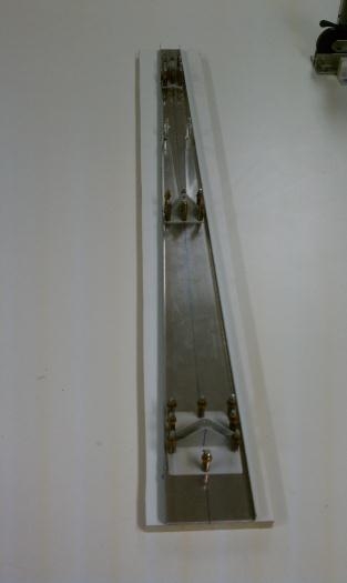

Brief Description:  Hinge layout on Vertical Stab T.E. Spar
This is my second vertical stab. Made a list of all the things I wanted to do differently. This time, I choose to drill the hinge schedule first and THEN drill the rivet pattern. This ensured that the hinges where on center line and in correct position.
Hinges in the correct place this time!

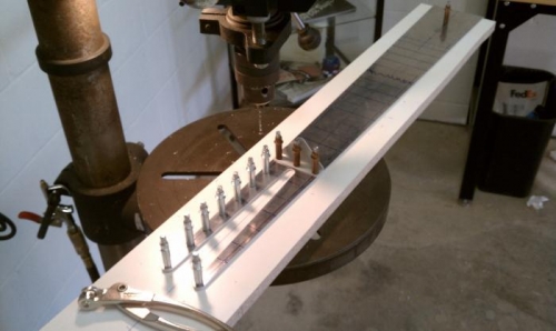

Now drill the rest of the holes! (#40)
SHAZAM! on center line!
