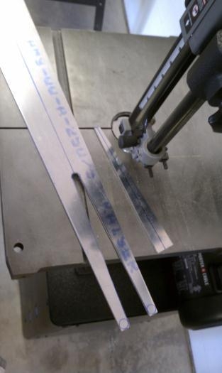

Cutting the "V" in VS408
Remove the center of the "V" as per drawing 6a. Had McMaster-carr make three band saw blades. I have found that 14 teeth/inch works well. Used a 1/4" circle template to mark the ends. Grinded to lines on the disk sander.
14 Tooth Per Inch blade
Used this template to round the edges
