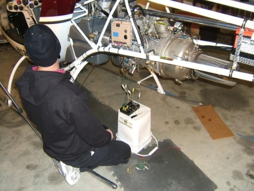

Monday covered the check over of cyclic travels, tail drive shaft alignment, tail rotor pitch settings, hood bearing alignment, installing the new rotor/engine tach and finding out I had the wrong plug wired on, setting the governor, first start of the engine, adjusting the fuel control and balancing the tail rotor.
Tuesday was setting up the rotor head, static balancing the main blades, installing the head, hang testing for balance and figuring out how much weight to add to the floor boards for it to balance with Doug in the seat, installing the rotor blades, setting the lead lag, out in the cold for main rotor balancing, more work on getting the tach wired in and the magnet ring installed on the main shaft.

Doug setting up the governor

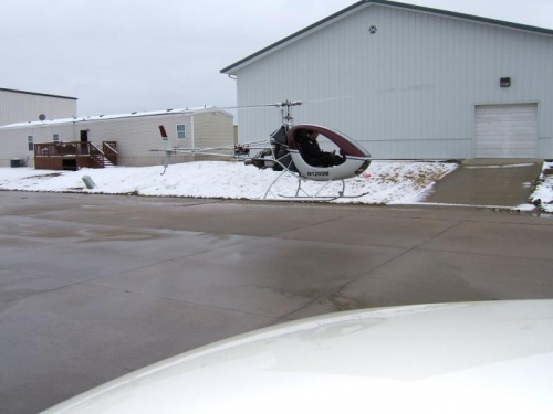

Doug making the first hover
