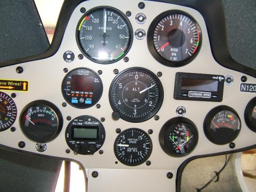

Cut out and applied red, yellow and green marking to the airspeed, rotor tach, engine oil gauge and exhaust temp gauge.

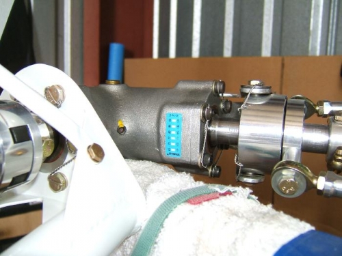

Affixed temperature sensitive labels to the transmission, engine gear box and tail gear box.

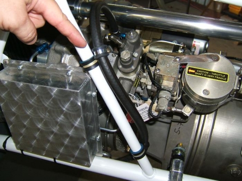

Used adel clamps to secure the fuel line to the frame where it connects to the engine's fuel controller.
Markings added to instruments
Temperature label applied to tail gearbox
Adel clamps securing fuel line
